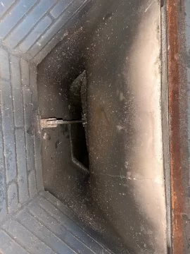

Thank you for the thoughtful advice. My personal observations after running Rumsford for 12 years is that it is not a net negative, and it is also not an effective heating tool for a large space. One day this week when had temps in the teens and high winds, my first floor was calling for 71, and temp was steady on 69 degrees. This is very rare when the HP cannot get to temperature. I got the rumsford going, and it was enough to help the HP get the space up to temperature. That being said, no matter how hard I run the rumsford in the winter, I can't get the first floor above 71. In the should months, I can raise the temperature to 74 if I run it hard.
The throat of the rumsford is very narrow, less than 4" wide. The installer wanted no part of breaking out the throat or dealing with the blue stone, he said I would have to get someone else to do it. When I spoke to the mason who built it, he stated that the throat is structural and he does not recommend breaking it out, even if it is just a partial removal to accommodate the liner. So, even if I could easily remove the bluestone as it has been suggested, the throat is the bigger problem. I have attached a picture of the throat. If I could find someone willing to put the insert in, the damage to the FP would be irreversible. Also, there is a significant offset on the chimney, which the installer mentioned could present a problem for the liner. He was talking about installing a 6" flexible, non-insulated liner, which I understand is also not ideal.
As I stated in my original post, my wife loves the rumsford, and today was no exception. Although she was originally hell bent against on a stove in addition to the rumsford, she is coming around on the idea of installing a separate stove somewhere else in the room. It is a pretty big room, so I think we can pull it off. I think this is the direction we are headed. We just need to figure out the best location for the device, and how to route the chimney pipe. The area above this room is an elevated deck with a rubber roof below it, so we are hoping we can send the pipe out the side of the house, then up. Lots of hurdles on this one, but I am determined to figure it out.
Thanks again for all the helpful advice, I really appreciate it. I will keep you guys in the loop as we progress (hopefully).
Ahh it's a prefab rumford. That changes things. You cannot open up the throat of them.
This has been my experience with my Rumford also.
See, these guys have no professional or ethical obligation do what a customer needs. Some of them just cherry pick the easy jobs that they want and say no to the others. That being said, there are some honourable ones.
I bet that Bholler would at least present you your options and risks, make you sign a waiver, and give you some sort of price on it if you said you absolutely wanted something done a certain way (while of course recommending what he feels is the best way). This is how things should be.
But of course it could have been a lot worse. They could have broken the fireplace, put in an uninsulated liner, charged you a bunch of money, and left you with a poorly drafting stove and your wife without a fireplace.
There is a significant offset on the chimney, which the installer mentioned could present a problem for the liner. He was talking about installing a 6" flexible, non-insulated liner, which I understand is also not ideal.
You are correct. Now this is a reason that the pros (admittedly more experienced and knowledgeable regarding design than I) will not disagree with me on. The two different installs are no longer equivalent. Both can be made to "work" but for sure they will prefer a straight pipe with insulation to an offset pipe without insulation.
Great! Try to think of a way to bribe her. I am trying to come up with a way to bribe or otherwise coerce my wife into going INSIDE our huge chimney to clean it, as her body is smaller than mine.
It is certainly possible to go out the side wall and up, and has been done many times, but if you can go straight up it is going to be the absolute best (especially if chimney is short and especially if it is not too cold). Would it be really intrusive to have a stainless steel pipe up through the deck? The people here can certainly help you with that better than I can, so best I am not too involved.
Thank the sweet Lord that you responded when you did. Many of our arguing points on this thread are now irrelevant with the new information.
That fireplace is not historic, but it is nice. I am happy you did not ruin it! Haha. I can sleep tonight.

Well yes I would tell him because of the nature of his prefab fireplace a liner for a stove or insert isn't an option. If he wants a stove it needs to have a separate chimney.
