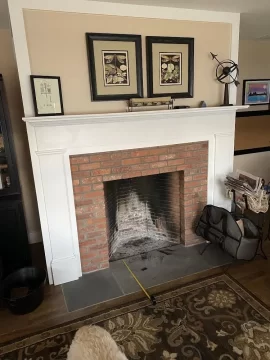

I an considering retrofitting a rumford fireplace in our 11 year old house. Has anyone been down this road? The original fireplace was installed for primarily aesthetics but we chose a rumford to minimize the net negative that is typically associated with wood fireplaces. We heat the house with ground source heat pumps, so we run the rumford in the evenings sometimes and on the weekends. Meeting our heating needs 100 percent is not a priority, but it would be great to take some pressure off the heat pumps in the winter months. If it were up to my wife we would continue as is with the rumford. I desire a wood insert or wood stove so that we can increase efficiency and so we can have a sealed, safe fire. I am considering a Princess insert, but there is considerable masonry cost associated with the liner install (need to remove bluestone cap), new raised hearth, and everyone is hesitant to render the beloved rumford inoperable.
Another option we are considering is installing a stand alone stove adjacent to the rumford with its own chimney.
I am looking for advice from people who may have been down this road before and like minded wood burners.

House size, configuration? Can't seem to find Applesucks2019! for a relative geographic location? ;) Fill us in. Welcome to Hearth.

I’d be looking at freestanding stove to install in/ in front of the rumford. Small top vent options might be a morso, Jotul 602, VC Aspen C3. Bigger rear vent Jotul F45 I don’t see the Princess insert really looking good? What are the dimensions

Most inserts won't fit in a Rumford without lots of modifications

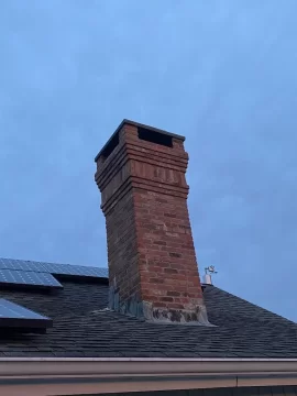

thank you for the feedback. The chimney is one of the reasons I am hesitating with the retrofit. The installer said the blue stone cap needs to come off so he can line the chimney. That would require scaffolding and at least 4 men up there to lift it off. I tend to agree with you, that perhaps we should install a stove somewhere else and leave the rumford. Unfortunately, the best unused space I have on the first floor is adjacent to the existing FP.

Hi Morsenow- the house is 3100 ft. Main level is 1800 and upstairs is 1200 Ft. Existing FP is in the great room (16x32) on the west side of the house. The house is very well insulated, closed cell foam beneath first floor and open cell in all exterior walls and roof joists. We Have one 3 ton water to water ground source heat pump that heats the main level with radiant and a 2 ton water to air GSHP upstairs. 10 KW photovoltaic system on the roof. I am hoping that if I install a stove, I will be able to decrease my electric consumption in the winter months, and maybe have a net zero cost on an annual basis.
Is the flue straight? If so it might be possible to push/pull the liner up from the fireplace. I emphasize the might part. Never done it. Seen a few videos. Put the flue cap on from the top and leave the stone in place??

Ok yes the liner needs to be insulated. No it absolutely should not be poured especially if a wrapped liner won't fit. Pour in insulation takes more space than wrap. By the looks of things it is a 12x12 liner so no issue at all. But even if it's an 8x12 you just use an oval liner. The liner can easily be pulled back out block off plate removed and damper made functional again in less than 2 hours. Installing a stove or insert is absolutely not ruining the fireplace. Infact the vast majority of people would consider it an improvement.
Btw an install in that fireplace should cost about half of what a new freestanding stove and chimney install would cost.
If they need scaffold and 4 people on the roof to handle installing a liner in that chimney they need to find a new line of work. In most cases I would simply cut a 1" diameter hole in the cap drop my hoist cable down through and pull the liner up. Then cover with a stainless plate.
If that isn't feasible that is at most a 2 man job to stand that up and brace it with 2x4s untill the liner is in. But I would probably do it myself
