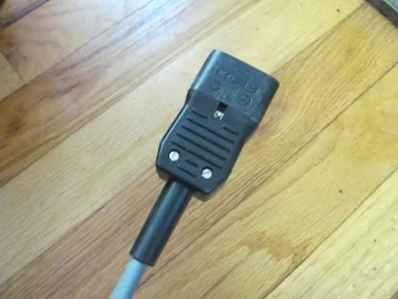

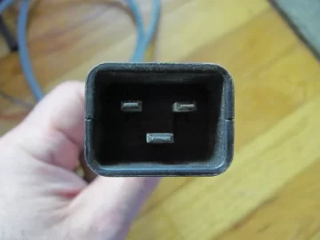

Is there a schematic of the wiring available here? Not having much look with google.
I have attached two views of the business end of the cable. Facing the connector as in the photo, Red (pos) goes to the upper right pin and Black (neg) goes to the upper left pin. The bottom pin is unused.
The workmanship is nice on the supplied cable but the battery clips are cheap but adequate.
View attachment 88995View attachment 88996
Many thanks. And I owe you a beer for not frying my stove.
