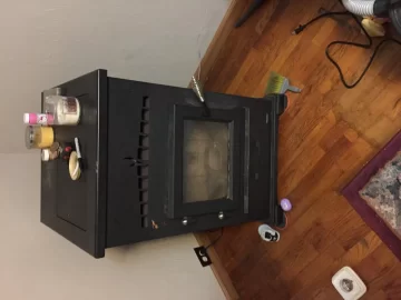

ok dont mind the mess guys i was cleaning in the are for her first fire up this year! Also what do you guys do for heats in say your basement? this is on my main floor its heats that fine but my basement is freezing and i do alot of work down there. Is it worth putting another one down there to work down there (2-4 days of the week for 6 hours) or should i look for alternative on this.
stove loves running on somerset bought 4 ton from menards this year already in the house and everything!
