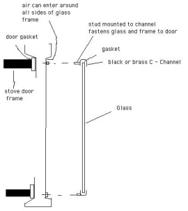

The enclosed sketch is how I remember it...

Is this your stove? You can clearly see the glass detail, and it is not made to plug up (with scotch tape or gasket).

Craig has posted a picture of the stove I used to have. You can take the glass off (via the studs) and use a very small rope gasket between the glass and door channel (you can use a small bead of furnace cement, but it will etch the glass and make it messy for future service) But It didnt seem to make a differeance what I did to the glass or the stove....... The only way to fire it hot was to make sure the firebricks on the bottom (over the shaker grate) had spaces between them (if you have the other type of Russo it is a steel plate with holes) And you have to use a fire poker now and then to keep those spaces clean. The stove on the other hand is what Craig calls "cresote monster" and you will be feeding it all the time with wood. I rebuilt mine, and no matter what I did, it would still run like a poor mans wood stove. Over night burns were not on this stoves list of chores unless I stoked it at 3 am. It has to do with the poor baffle design and the silly rear draft control. My big Oslo burns the same or less wood than that little Russo did. Dont get me wrong, I guess I just expected too much out of that little smoker........
