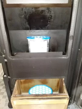

Every Year I have rust on the brick panel (ef 3)
When cleaning I wash the rust off it is just surface rust
and removes very easily . This I have been doing for
the last 16 years . the panel shows no deterioration
so I do not bother with any of the anti rust preps
I spray the inside with cooking spray and then 2 containers of damp rid and you can see in the pic I just took ,no rust and both damp rids are half full of water [Hearth.com] Rust in Stove's Firebox

Exactly what I do.Rich.
also get a good amount of water in both containers.

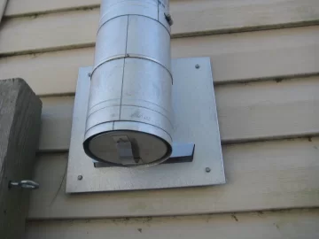

Thanks everyone...how are you covering the oak? Mine is pretty flat with the siding. I had tried the versions of cling wrap that have adhesive on them but they kept falling off. I will try the cooking spray next season.

mine as u can see is different,
i just shove a rag into the vent.
if yours is flat you could disconnect from inside and plug up or cover it from inside.

When I had the flat style oak I taped it shut with foil tape. With the bigger oak for the Harman I also stuff a rag in the hood.
