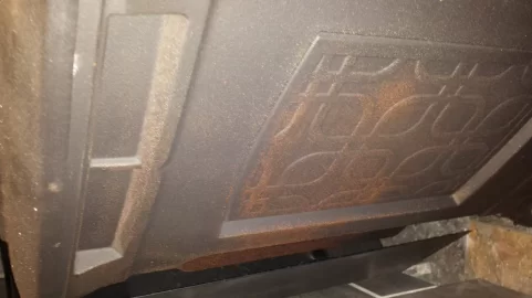

So, would anyone find this acceptable?
[Hearth.com] Rusty stove less than a year old.
This fall we had some really cool weather followed by a couple warm muggy days, everything in the house got condensation on it one day when I opened the windows. This is what it did to my stove.
I understand why it happened just wondering if I should push on the one year warranty issue? It's within days. I find it a bit disturbing that a stove less than a year old costing nearly 2 grand can't handle some humidity but the 100 dollar heat shield can.

Condensation on cast iron is going to rust it every time. The rust in your photo is probably more pronounced than what it looks like with the naked eye. At least that's been my experience. I've had cast iron stoves that looked fine and then I took a photo of the stove and with the flash it was covered in rust that I never even noticed! I think with a flat black cast iron stove you just have to figure you are going to have to paint it every 2 or 3 years if you want it to look new. I always just painted mine with a brush to avoid the mess of overspray, but many others here at the forum swear by spray painting and say they don't have such a problem. Good Luck.

I've seen this happen on stoves that have overfired, or been really really hot. That stove is no different than any other cast iron around the house. You yourself said there was condensation on stuff, I wouldn't expect any different. Just grab some flat black stove bright and touch it up.
Clean it first with steel wool the alcohol.

What kind of stove is it? It's hard to see but looks like a hearthstone.
Hearthstone Shelburne. Love the stove, just not crazy about the new look.

I wasn't saying you have overfired it. I've just seen this happen . There is no need to do anything special to the area before you paint it. Just a wipe down with a course rag is all that's needed most of the time. The stove was painted with Stove Bright Flat Black from the factory.
Sometimes there's a few spots that flake off during the first fire. It's where it got a little stove cement on the iron before it was painted. It's common with cast stoves. That's probably what happened with your door paint.

No coverage, the reply was:
"John
Lookin' like steel wool and high temp paint sorry just heard back no coverage for this one."

If you can keep everything in your house from being covered in condensation, your stove will no longer rust. Get it painted and fix the humidity problem.

I agree, that would bother me too. Oh well, give it a good scrub, paint it, and move on. My dad has had good luck with "stove polish", it is a paste that you rub on with a rag. It has kept his stove from rusting (in his shop) much better than paint over the years. A thought if you want to give it a try.
This is the stuff he uses
