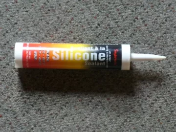

    Hi temp silicone is a much better option on P and/or L vent pipe.
    Eric

    Yeah, I'm not big on red silicone on black pipe. Isn't there
    a high temp engine RTV that may work or is that only good
    for 400 degrees?
    Glad to hear that it's not just that I didn't totally follow the
    directions. :p How many people even READ them? Give
    some credit.

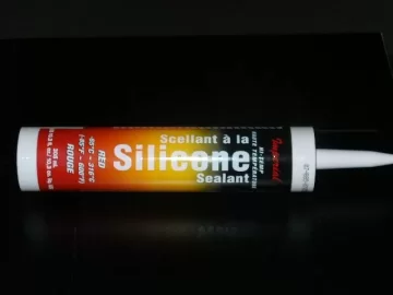

    There is a black ("noir" for you north of the border folks) but it is rated at 450 degrees.

    Um... yes... click the picture in post number #3.
    600 F right on the tube.

    That's likely not the continuous rating, it's probably only "heat resistant" up to 600°. Meaning that it cannot take more than a few brief periods at 600°. Can someone read the back and state the true (continuous) temp limit?

    Nothing on continuous but flexible from -85 f to 600f
