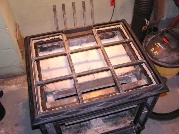

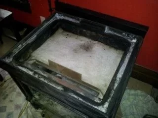

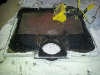

I am rebuilding the top of my Mansfield.... I see that Hearthstone sells its own brand of stove cement. Should I use that, or can I get by with just heading to the hardware store and picking up some rutland cement? This wil be a metal to metal bond as the top plate sits on the metal frame. The stones are still secured in the top plate so there is no need for bonding any of the stones.
Thoughts? Suggestions?

Can't offer any advice one way or the other, but I did rebuild my stove. As I was redoing the entire stove, I bought Hearthstone cement and used it everywhere.
One thing I can say about Hearthstone cement is it seems to be hit or miss whether you'll get a usable batch. I think 3 of the caulk tubes I bought came pre-cured. I bought mine through a local dealer. You can apparently buy it here also...

Having rebuilt too many Hearthstones to count, I can say that the H'stone cement definately bonds better to the stones, and seems to hold up longer. They sell it in a 5 lb. tub which I've never had "pre-cured" on me, but tubes certainly do that, no matter what kind of cement. Tub works fine too, really no need for tubes on these guys, unless you inexplicably don't want to bath in it...
Seriously, go w/the tub, man.

Mortar deteriorates. My stove was 12 years old when I bought it. But also with mine, the plate that supports the top stones had warped and cracked. I wouldn't worry about that though. I believe this was an issue unique to the 1st gen Mansfield.
Yeah.... Mine went BOOM. Rebuild is done. All of my stones stayed in place on the support rack. I just had to reset the whole rack (stones intact) on the stove. Burning as I type!
