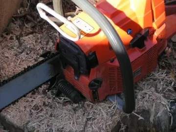

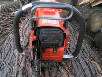

I dual ported the muffler on this beast one hot day last July.Run great before,even better afterwards.Would like to install a 2100 piston/cylinder eventually,but dont know if that would work or not....

044 is an easy one for muffler mods. Use the 046/MS460 Austrailian muffler or it's aftermarket equivalent.
http://www.baileysonline.com/itemdetail.asp?item=QA 11281 400616&utm_source=nextag&utm_medium=cse
You can do a DIY on your existing muffler by adding a port or widening the existing one but for the 044, Dual-Port mufflers are cheap and work.

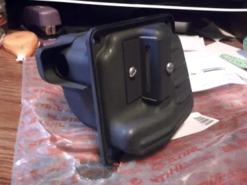

For the record, here's a pic of what the Stihl OEM version looks like. One of these just happened to show up here recently. ;)
