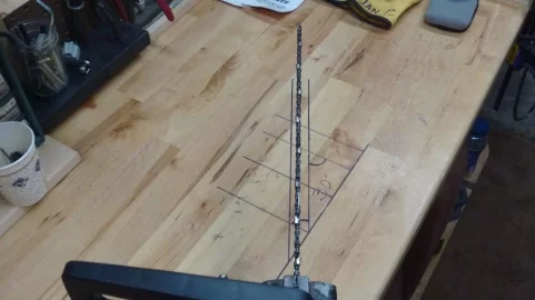

I clamp mine in my bench vise. Since I sharpen my chains at a 30 degree angle, I marked 30 degrees on the bench. I line up the chainsaw with the mark, then sharpen at a 90 degree angle to the bench. After I do one side, I swing the vise around and sharpen the other teeth. [Hearth.com] Saw Vice?
Dan I like your set up.
