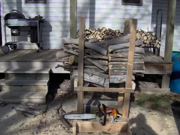

IMO it IS faster to use a sawbuck on smaller stuff from 4" to 9".Especially when you have at least 3-4 wheelbarrow's worth.I had a smaller one over 20 years ago made from non treated spruce or something.That eventually turned to compost.This past July I made a bigger stronger one from SS screws & treated 2 x 4 & 2 x 6 odds & ends from my junk pile.Should be around after I'M compost ;) Smaller stuff from 1 1/4" to 4" or so,that all gets cut to length on older 10" Delta cast-iron miter saw.With 1/8" 40 tooth carbide blade,its much faster than any chainsaw you'll find,because of much thinner kerf from the blade.
Its much harder as I've gotten older to be constantly bent over cutting all those shorter pieces,then bent over again picking all them up & making 10 times as many trips carrying them to trailer or pickup.
3 to 9ft poles,haul them in,load sawbuck,cut & repeat. Marks at 16" & 32" with a Sharpie makes things easier.
Plus sawbuck keeps the tip of the bar outta the dirt,kinda hard to avoid that when bucking small rounds in the field.
