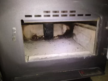

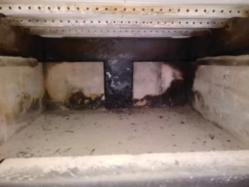

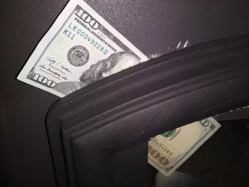

Yes, we're going on the third season and no problems so far. I just checked everything quickly before posting this. There is one cracked brick to the center right- no doubt from fuel installation sticking the back of the stove.
One thing I have noticed is if you are not careful with some pieces of wood you can damage the baffle boards. Mine are original and holding up. The rounded corners of the plate and the tube screws appear intact this morning. Quality counts, and so does the quality of wood and owner operation. There are nicer and more expensive stoves available but a lot of the reviews seem to be all over the place which leads me to believe there are quality control issues. With the exception of one brand we looked at, but I feared the darn thing is so expensive that the reviewers would be embarrassed to say anything negative about it. And, now I know why these stove manufacturers recommend the dollar bill test. Because that is what you are left with as they are holding the other $99. We'll see- satisfied so far.
