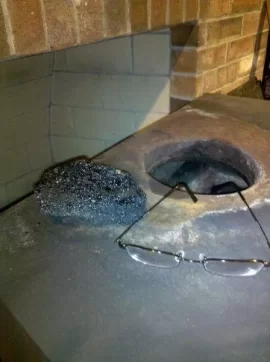

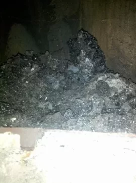

Here are two pictures for haa haa's.
One is a picture of one of the chunks I pulled out from above where the block off plate was, there were a lot of larger ones but I was using a new smart phone to snap the shots and I wasn't very keen on killing it with my nasty hands.
One is a picture of some of the stuff that was piled up above the block off plate.
