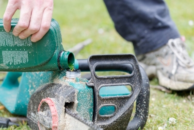

Advantages of replacing chain oil with vegetable oil:​
Environmentally friendly – Using vegetable oil as chain lubricant poses no threat to the environment.
Effective – Vegetable oils have natural properties including good lubricity, resistance to shear, a high flash point, and a high viscosity index. These qualities lend themselves to chain lubricant requirements similar to petroleum-based chain oils, and do not contribute to chain or bar wear over time.
Safer for the user – Chain saws run at high RPMs which result in oil misting. This can affect the user through inhalation and or dermal absorption. Canola-based chain oils have low vapor pressure, which reduces inhalation of fumes by users. In this regard, studies have shown vegetable oils to be safer than petroleum based oils.
Cheaper – A 4 liter jug of chain oil costs $12.99 ($3.24/liter) at my local big box home supply store, while a 3 liter jug of canola oil costs $7.99 ($2.66/liter).
Readily available – Canola oil is a renewable, sustainable farm product. It is readily available at most grocery stores.

Very interesting, might have to try this. That guy needs to sharpen his chain, throwing a bunch of dust.
