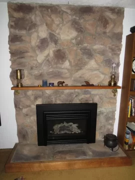

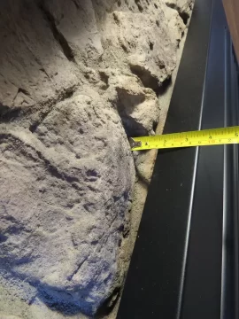

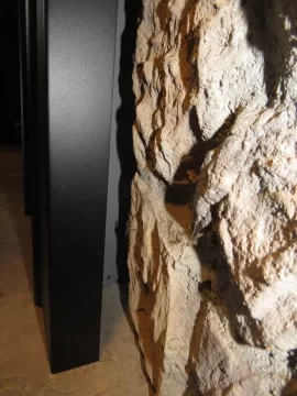

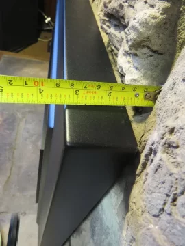

Recently installed Valor G3 Nat Gas Insert into existing hearth (replaced 25 yr old Valor 470MN). The fireplace wall is in natural stone - very uneven - so G3 has gaps between trim/unit and stonework - up to 1.5 ". Result is that a great deal of heat from the Valor unit escapes upward to the wood mantelshelf, which gets very hot. (Cannot touch it!) Problem could be solved with horizontal strip of some heat-resistant ceramic-wool board say 1/2" thick across the top of Valor trim suround to seal the gap . .. Any comments/suggestions?
