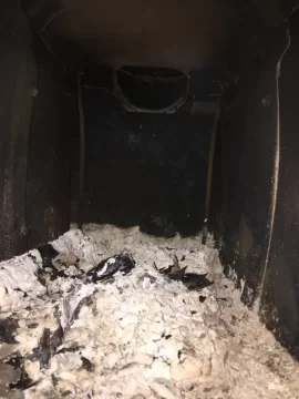

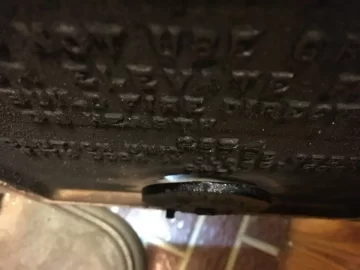

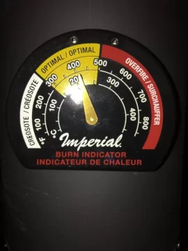

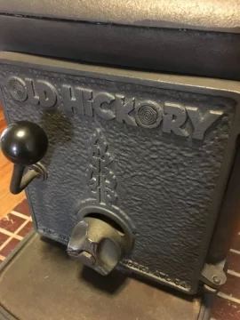

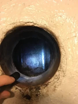

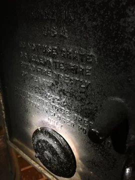

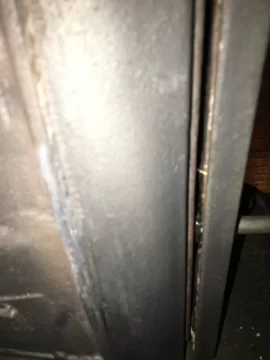

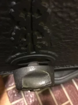

Here are some images of the air inlet wide open. The wood reads 10% moisture.
The stovepipe exits the rear of the unit and runs 37 inches vertical and elbows. After the stovepipe elbow there is a short 10 inch horizontal run into the chimney. The chimney is 7x7 with no turns. Straight shot to the roof with no cap. It’s 20-25 feet from where the stovepipe enters to the top.
There’s is one very small obstruction at the second floor access where another stove had once entered the chimney. It’s really just a small tuft of insulation but does take up maybe 20% of the cross section there.
This will be remedied shortly by removing it and bricking up the old access.

When I crack the door juuuust slightly it runs just right. This allows about the same amount of air into the box as it has before i sealed it up. I’m confident that sealing the unit has caused my performance issues.
However... it’s very possible that the additional air provided by the leaky box was making up for some other deficiency in the system. Effectively allowing the stove to cheat and overcome some other derogatory factor.

With regards to the sealant, maybe I wasn’t clear in the earlier posts. I sealed up both the firebox and the first section of stove pipe. The newly sealed section in the firebox was right next to the door and was not functioning as exhaust. It was providing additional unregulated intake air to the fire.
