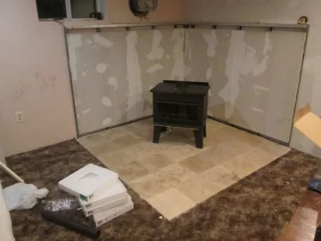

I'm almost done with a hearth/pad/wall shield I'm building for a small woodstove. Floor for the hearth area is 12x12 "Travertine" (Limestone) tile from Menards. I just finished grouting tonight and have been trying to figure out if I should seal the grout or tile.
I don't know the specific chemistry, but I assume most sealers work by producing some kind of oil/plastic/wax coating. If a coal falls out of the stove door while loading, having an oil/plastic covered surface for the coal to fall onto seems like a bad idea.
Have any of you been down this road of unlikely worry before? Is there a good solution? Right now I'm leaning towards leaving the floor unfinished and just embracing the "aging" of the floor.
Also, the next-summer plan for the wall/heat shield is to build out a 4" block wall of limestone from up the valley. Not sure how to split the stone by hand, so if you have any suggestions...
