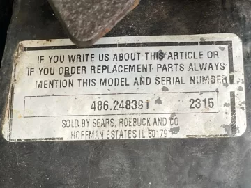

Pic 0 - LT1000 Snow Blower Attachment Tag with Model & Serial # for parts ordering.
