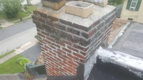

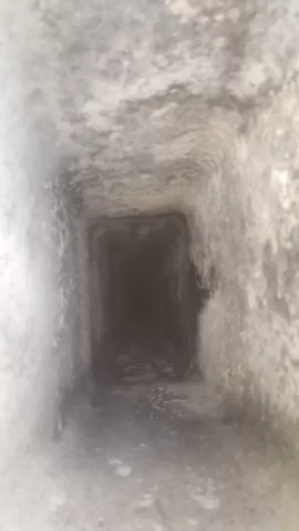

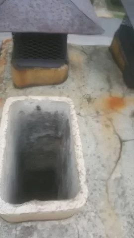

So, I'm really close to buying a house, (settlement was supposed to be yesterday, but the seller didn't have the repairs finished), and an HVAC guy told me I needed to get the chimney looked at. The chimney guy gave me an estimate of 3k for a new liner, sweeping, cement work, and tuck pointing. He insists that the liner MUST be replaced. He included these photos in the estimate:
I'm getting conflicting opinions that the estimate is way too high, and that the photos show that the chimney looks fine. I don't know what to believe! Please help!
If it helps, this is in southeastern PA. The house is about 100 years old, and the chimney guy says that the inside of the chimney should look orange from the terracotta lining. An oil furnace and fireplace is part of the chimney.
Edit: Sorry! Here are the photos!
Thanks!!

I have a feeling the chimney was not diagnosed by color but the sweep said it should have an orange liner just to illustrate what should be there. I would guess there is no liner. But without the pics i am guessing.
Ugh sorry!! Thanks everyone for your patience. Here they are:

Hm, I'm not sure- how would I know? Sorry I'm clueless about this!
Looks like there are 4 flues in this chimney so the odds are it is independent. A good sweep can verify and inspect with a camera to give you an accurate assessment.
I failed to mention that this house is a twin, so I guess it just has 2 flues? I'm going to get another chimney person to inspect it and give me an estimate. Thanks!!

Well the liner is badly deteriorated and needs replaced. I also see lots of flashing and masonry work needed 3000 does not sound at all unreasonable to me.
