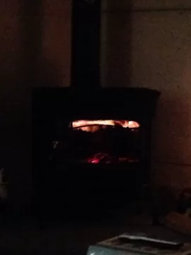

This was off 4 splits of 17% oak, a piece fell so it flared a little more and looked like this. Secondaries lasted an hour stove top in spots were over 450 cause my temp gun reads hi lol. Some spots read 420 or so. After secondaries were done for a little stove dropped to 350 and stack to 500. Maybe the stack therm just dont drop quick enough!
[Hearth.com] Secondaries after 5 minutes, can I reduce air?

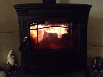

This was the other night with same temps
Isn't the stack temp supposed to be a little higher than the stovetop temp for a clean burn? I've never measured it so I am guessing here.
Idk lol i though i read it should go lower once stable! I need to get my wood sitchu set up better also and season more then a year!
