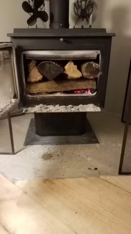

I will add those splits were a little smaller than I usually run. Attached is what my usual load looks like but last night I had a bunch of smaller stuff that might have contributed to the higher temps. The splits in the picture are about 6" across at the widest part.
  • [Hearth.com] Secondaries question
You are a messy tender, lol.
Haha I'll admit it, I am. The sad part is I just cleaned that ledge night before last. I usually clean out the old ashes every night and leave some with the hot coals and get the ledge at the same time.
I guess that's what it's there for!
