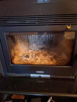

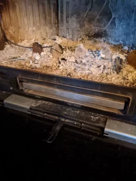

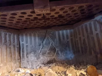

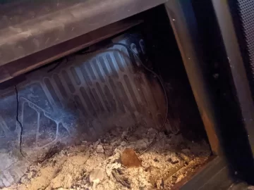

Attached some pictures of my insert. It is a Montegrappa Compact 80.

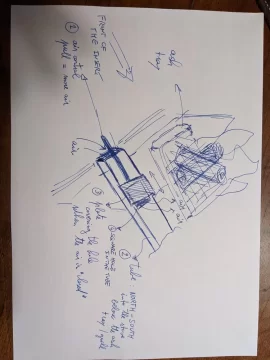

NOW - I would like to improve the BURN TIME / EFFICIENCY.My idea is the following:1) find a way to better control the intake primary air and being able to "shut it down" to almost zero2) practicing some holes and being able to inject secondary air on the top of the box by tubes ...(interesting this box has got a kind of vermiculite on the top..that gets VERY HOT (it turns red...).To shut dow the primary air one very simple way is to "close" partially the grid where the has falls...
