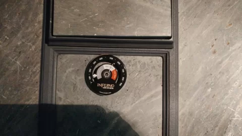

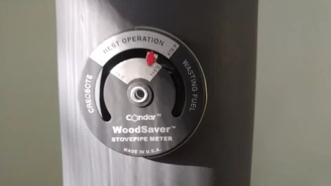

There is no specific cookie cutter draft, due to different chimney heights, wood species, moisture content, low pressure, high pressure ect,... there are many variables to specific woodstove setups, some members that burn have excellent draft and can turn the stoves all the way down and still achieve secondary reburn, others can only turn the air control halfway and achieve the same results in secondary action. Learn your stove setup, about the only thing you can control is stove top temp, get the stove top to 450 then start cutting the air back a 1/4 at time, wait for the burn to settle before cutting the air back again, this could take 10-15min until you learn your minimum air setting, the idea is to just have calm almost whisper flames in the firebox, and a rolling top action above the wood, the air tubes just create turbulence by introducing fresh o2 and it reburns the unburnt smoke / particles from the main fire, a good burn should settle between 550 - 650 deg stove top, also be forewarned that you need a stove top thermometer, some members get confused and put a chimney thermometer on the stove top and vis versa, they are calibrated slightly different and will give a false reading of true temps.
Reactions: Grizzerbear
be forewarned that you need a stove top thermometer, some members...put a chimney thermometer on the stove top and vis versa, they are calibrated slightly different and will give a false reading of true temps.
That's the first I've heard of that. I know that the colored ranges are different on a flue meter vs. stove top meter ("creosote, "best zone" and "too hot" on a Condar Inferno stove meter)but I assume that the actual temp numbers themselves are accurate.
On the stove top meter, the marked sweet spot is 400-650F. On the flue meter, it's 230-475F. I believe I could toss the flue meter on the stove top, and I would get the same temp as the Inferno shows.
[Hearth.com] Secondary burn help [Hearth.com] Secondary burn help
Yes, the range scales will be different, but the actual temperature reading (if it has a temp scale) should be the same.
