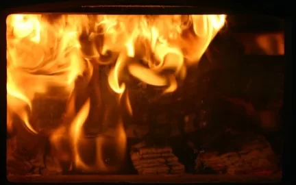

Well anyway, here's yet another shot of my little CFM workshop stove cookin' with the primary shut completely down. Took this pic about 5 minutes ago. Rick
