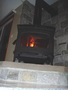

Secondary burn coming down out of some of the baffle plate holes in my little CFM shop stove. Rick

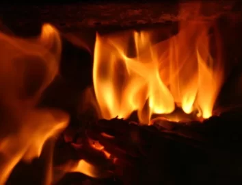

A little of the aforementioned secondary burn:

Thats Cool!

Great balls of fire! That's hot!
It sure is nice to see some burning pictures coming in. We prolly won't be getting the live show for another week or two.

Here either. Those are last year. Just warming the stove up before bed time here right now and letting it burn down since it is in the 40's at night.
