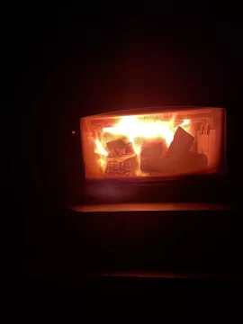

My old man is a big wood burner and I have had my fair share of fires, but the stove I learned on was an old northern comfort with no windows, so learning this new, modern regency i2450 has been cool. I probably have 5 fires in the this stove, which was already in the house but only a year old, and am starting to realize that I don’t even know what I don’t know. Starting the fires aren’t my problem and I don’t struggle with keeping it lit. I know I should be aiming for secondary combustion, but an. Not certain what that looks like but I have some pics of what I think I should be at based on reading here. Can someone let me know if I’m close. Or if I should be doing something with the draft.

Welcome. It can vary depending on where you are in the burn. It’s a little hard to tell from the pics - the second one looks most like it to me. Generally one of these:
- Flame coming directly off the wood and getting a boost around the burn tubes.
-Flames coming directly out of the tubes like a gas grill without a connection to a flame below from the wood.
- Lazy clouds of flame hovering over the wood often with mini bursts
If it’s your first year, I’m guessing your wood is still a little wet. Try burning a pack of compressed wood blocks or add a few pieces of scrap lumber in with the cord wood. For what it’s worth, I didn’t know what secondary looked like until my second year where I burned a pack of Bio-Bricks. It was good to see how the stove operates as designed with dry wood.
Secondary combustion is easiest to see when you have a nice dry load of wood and the fire "separates" after you turn the primary air down...you'll have very little to no active flame down on the wood itself, and there will be nice flames up top against the baffle/secondary air tubes.
Example: (though it may be an extreme example, since there is no active flame showing on the wood...doesn't always happen that way)

Your second pic definitely looks like the secondaries had just started. If you look at the pic I attached you can see the bright orange flame. That is the "primary" fire. It's coming directly off the wood. The purple and bluish flames that are see through are the secondary flames. They normally come from the top but not always. Some times when the air is really slowed down the smoke is catching fire immediately out of the firewood and can be hard to differentiate between secondary and primary when you are starting out. Stove temps have a lot to do with amount of secondaries. I normally don't get robust secondary action until I reach 350-400ish stove temps. When I hit 500 and beyond I get the propane grill....my favorite....flame action. This pic here is still with the air control at about 25% open and stove temps at about 300 I believe.

Yes - I'd say the pics ending in 'D0' and '32' both look really good. What I typically look for is a translucent flame (you can essentially see through the flame) vs the yellow opaque flames and the holes in the secondary air manifold look like a small lighter or torch with flames around them.
The other way to tell is that once you get an established fire and start shutting down the air to the stove, the stove temp rises. The more you shut down the air, the more the temp rises. Temp will keep rising to a point and level off, then you have control of the stove - shutting down the air more should lower the temp. It is sort of like tuning a carburetor for an engine - you want just the right mix of fuel and air for best combustion... but in the stove case, you control the air, not the fuel.
