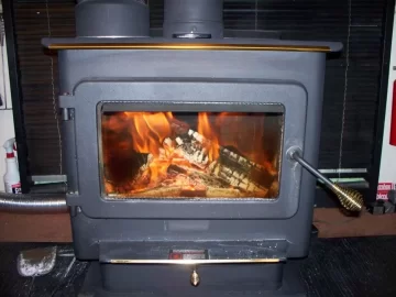

The flames coming down from the top are my secondary burn.
