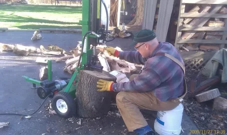

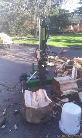

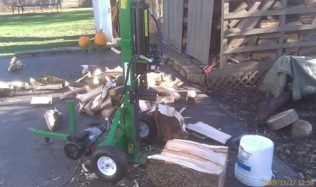

Great splitter. Very happy so far. I've split about a cord since I got it. Quiet is the key word here!

Definitely looks like a nice machine... One very minor comment - I've tried several different things for sitting on while splitting, and found that a milk crate works better for me than a bucket. Seems to hold my weight a bit better, and I like the very slightly larger size and shape of the sitting surface... I also found the bucket was a little to tall, the milk crate gets me at a better height. However the best seat is what I have over where I work with my friend, he has a padded mechanics height stool, with a swiveling seat. Comfy, and allows me to turn easier to reach the rounds on the "to be done" pile that are behind me...
Of course everyone's preferences are different, so whatever works - just mentioned as it is something you might find helpful to experiment with.
