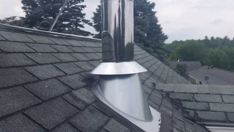

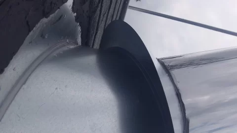

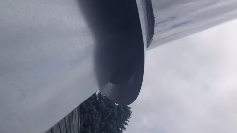

I don't know about Selkirk but due to the arrangement of my chimney setup which is supervent. I purchased the through the ceiling kit and didn't need the attic insulation shield. I used the support box in the first floor then roof flashing on the roof. since pipe runs in chase to second story cathedral celing. (the one the kit came with was the wrong pitch so I had to buy one for the steeper roof.) anyway long story short after installing the storm collar and looking at it I thought it looked insufficient as well as since the flashings usually cover a range of roof pitches so the storm collar sits on top of flashing at an angle. so I took the wider attic insulation collar and installed that right above my storm collar. just a thought if your having problems with water coming in under the storm collar you might want to get a collar for the attic insulation shield and install that. if you look at the pic you can see the original narrower storm collar up under the insulation shield collar
