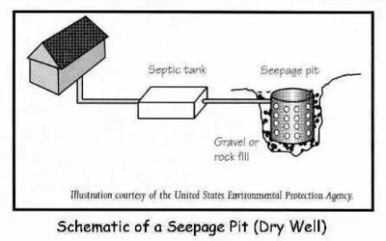

Maybe you don't mean what I'm thinking of, but I thought that dumping sewage into a dry well was illegal in most places.
Maybe you don’t mean what I’m thinking of, but I thought that dumping sewage into a dry well was illegal in most places.
Perhaps I should clarify.
A Seepage pit. Round tank with River Rock in the bottom and holes in the side to leach the effluent.
See pic.
And yes, into an abandoned well would be illegal.
Dry wells are much easier to maintain.
I wasn't thinking of an abandoned water well. A "dry well" to me meant an essentially unlined man-made cavity (covered pit) in the ground with a pipe dumping into it and no septic tank in between. My grandfather's cottage had one before modern septic systems became the norm. What you're showing just seems like an alternative to a drain field.
I wasn’t thinking of an abandoned water well. A “dry well” to me meant an essentially unlined man-made cavity (covered pit) in the ground with a pipe dumping into it and no septic tank in between. My grandfather’s cottage had one before modern septic systems became the norm. What you’re showing just seems like an alternative to a drain field
That sounds like a small lagoon?
See pic.
What state do you live in? That type of system was used many years ago (50+), sometimes with more than one seepage tank. Now they are not legal in many states. Most states require the bottom of the drainfield to be no deeper than 4 feet, and must be at least 3 feet above any sign of groundwater. Making many system very shallow or even mound systems. The filter on the outlet end of the tank is nice, but I would make sure you clean it more often than 2 year intervals. Otherwise you may find your basement floor doesnt make a very nice drainfield. I'd clean it (rinse with garden hose) at least every 6 months.
What state do you live in? That type of system was used many years ago (50+), sometimes with more than one seepage tank. Now they are not legal in many states. Most states require the bottom of the drainfield to be no deeper than 4 feet, and must be at least 3 feet above any sign of groundwater. Making many system very shallow or even mound systems. The filter on the outlet end of the tank is nice, but I would make sure you clean it more often than 2 year intervals. Otherwise you may find your basement floor doesnt make a very nice drainfield. I’d clean it (rinse with garden hose) at least every 6 months.
I live in Iowa. And it was a special circumstance permit.
The land my house is on is a flood plain. My yard has a high area and a low area. To do a leach field would have required that the Leach Field was in the lower land, closer to the lake area, and sometimes under water. A seepage pit was a better alternative for both me and the environment.
