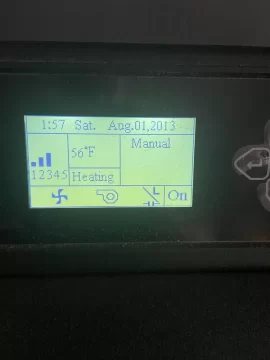

Same this as stated in original post. It ignites perfectly fine but when it goes to the heating process the auger stops feeding. In the picture I have attached there’s supposed to be another symbol lit up between the two on the bottom right letting me know that the vacuum switch is on. I read in the owners manual that the fuel will not be fed if both the vacuum switch light and the hopper lid switch light are not on.

The missing symbol is the V, for vacum. {Between the L and that little blower}
