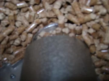

I have a go pro camera and a small light. I guess I should try to put the camera and light into the hopper sometime when it is low and watch it. It may be fun to see what really goes on in there.
i think you are right.. since then i have this tendency of going to the hopper and push all pellets towards the center.. i don't trust gravity to pull them towards the auger. I just filled it up again, so i'll test it tomorrow once it starting to starve.

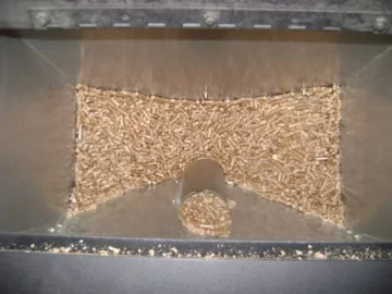

Here's my hopper as of last night. I did not help the pellets in any way by scooping them to center etc.
[Hearth.com] Serenity - Dumb question about feeding the stove
I noticed that the heat coming from the stove was a little lower than it should be. The auger was still grabbing enough to keep going, but the auger had gaps of low pellets.
Reactions: rich2500
If you are seeing the auger, you should have already added more pellets unless you are planning to run it out to vacuum the fines that collect at the bottom. :oops: When hopper gets that low, the auger can not pick up a full load. If the stove is on it's lowest setting, it is very frugal on how much is feed to the pot i.e auger off for far longer than it is on.
I am not debating that, what I am pointing out is the fact that if all pellets fell to the bottom (as the design intends to accomplish) the auger would always be covered by the amount of pellets left in the hopper.
Thus Deezl's point of "bridge" is what was happening here. It has not happened lately as I tend to go there and shove the pellets towards the center. (reason is that I am measuring how long i can go with a single bag..right now is 24 hrs)

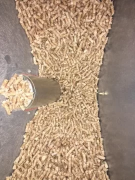

Here is a picture of a left alone feeding process.. after i shoved the pellets around, it filled the bottom high enough to cover the auger and more. So yes, if i left it like that it would have starved as auger would not have picked up any more pellets due to pellets "clinging to the walls" and not falling to the bottom of the hopper. This design should include some sort of up and down mesh/grid/grill that ensures movement of the pellets within the hopper. This amount shown in the picture would have lasted for 3 more hours.
So by your account your gravity hopper-feed system would be 89% efficient. And it was still running I presume. Not bad imo
It is actually 87.5% :)
And i don't think this relates to "efficiency". Is not that is feeding more than expected, is that it stops feeding when not expected. Anyway, i guess this is the reason why the fire went off on me.
24 divided by 27=88.8. From your post you had a potential for 27 hours of burn time."
