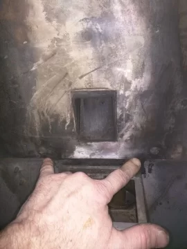

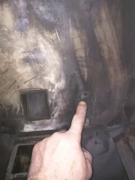

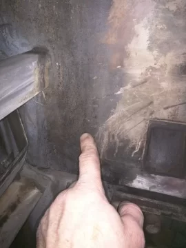

I have had the stove for 3 yrs. and it has been awesome until recently it started making metal expanding and contracting sound at all times as you can hear in this video
so last weekend I start digging into the stove to find that the steel plate that is plug welded to the back wall of the stove had the 2 lower plug welds popped loose and the plate had a gap.so I drilled holes through the plate and put bolts in which pulled the plate against the back wall of the stove again.I thought that was definately the cause of the sound so I ran the stove that night and it seemed much better.The following night I fire the stove again it seems good I get up in the morning and the sound is back like you hear in the video.The following night I start the stove and go about my thing and 10 mins. later the wife is yelling there is something wrong with the pellet stove it just made a loud bang at it's full of smoke I come to check it out to find the firebox full of smoke from an ignition explosion I get that mess cleaned up and the wife did not wan't me to fire the stove up again but I did anyway and it relit and burned all night just fine. I put a call in to Ardisam and they asked for pics and the video which I sent to them but have not heard anything yet. watching craigslist like I always do I see a dealer offering the Ravelli Francesca for 1750 I thought thats a damm good price and at just the right time so I buy a white Francesca (see other post Ravelli Francesca ) at this point I don't even know what to do with the Serenity because I will not sell it to anyone the way it is, maybe sell it as a parts only stove. This all really sucks because I really liked the serenity but the wife no longer trusted the stove so it was time to go.

Thanks for the video and detailed description. My south stove makes a loud bang once in a while when initially heating up from expanding metal. It is a factory design flaw of jig building to weld properly. But given where it's made, it is understandable. I shall watch the places you mention to make sure the welds do not fail. If they do, I will weld them back up. It is the warpage of welding the box at the factory that causes each stove to have a slightly different characteristic. An analogy I would refer to is like a plastic water bottle. If you pull it out of the cooler and drink the water, then put the cap back on the cold bottle with a few crinkle dents in it and leave it in the warmer area you are in, it will pop and crack as the air inside expands and pushes those little dents back out.
The expansion noises in your video are mostly the same. It is a inconsistantly welded up fire box. Since you bought a replacement, it would be fun to take the old serenity and run a few weld beads near the area where the pulled plug welds popped and run it outside for a few cycles to see if it cured it. Just for the knowledge of it more than to repair a broken stove. If it fixes it, you might use it in a garage or something or give it to a friend that wont use it in a house. Otherwise, I think you are right to sell it as a parts rig. May have to purposely damage it in some way structurally to make sure it does not get used in a house, but someone would like to have the parts. If I were driving distance, I'd buy it for parts.
