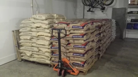

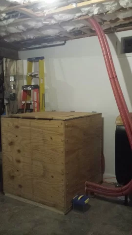

I have a nice pellet boiler and it is indeed very automatic. See my install thread in my signature. Maybe a little cleaning and ash removal every month, maybe more. I built a one ton bin in the basement and feed it with bags that I also store in the basement on pallets. The pellets get fed from the bin by vacuum, which is more flexible than auger.

Velvetfoot is right about the BioWin. I check mine every two weeks, dump ash and clean every 600 hours which is about a month. I burn 14 ton a season. I use a wood bin that i build that holds about 2 ton and fill with bags. Takes about 1/2 hour to fill. Then air moves the pellets to boiler. Everything is in boiler room. Boiler, Pellet bin and pellet storage about 4 ton ready to go in bin. I love it so much i just got another BioWin to do another building and house/ workshop. Have not got it hooked up yet.

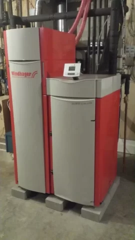

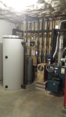

Here are some pictures of my setup.
[Hearth.com] Set it and Forget it? [Hearth.com] Set it and Forget it? [Hearth.com] Set it and Forget it? [Hearth.com] Set it and Forget it?
