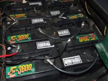

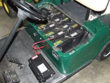

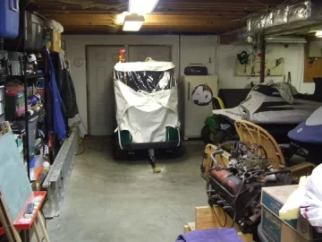

I know there has been alot of questions before about battery backup, and tonight I set mine up before the first winter storm of the season.... My golf cart is directly underneath my pellet stove, so I drilled a hole and ran a cord to plug the stove in, I then re-wired the cart from 36V to 12V and installed the Harman 512H... The six 6V barrteries when fully charged will run my stove 10-12 hours!!!

My stove can't get that out of a car battery, it only burned 2 hours using my boat battery... I had some voltage left with the golf cart batteries, but like I stated earlier, I fired the gen up once I got in from work... I'm satisfied with 10 hours...
