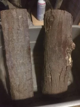

So this past weekend I loaded up my wood box for the week with a pretty healthy dose of my shagbark and red oak. This would be/is the first big run for this stash. I was pretty excited as I've never had great quantities of either in the past.
Well while I'm not horribly disappointed I'm far from thrilled with the performance so far. I loaded up the osburn last night and had it cruising by about 815, I woke up around 230 and came out to see what was left and for the second night in a row i had limited coals left in the back and a awful lot of ash and the box was 200-230, and house temp was down to 64, from 69 at 900 with a 675box temp. Over night temp was 19.
I've had far better results from a box full of ash or locust.
Now to be fair this wood was cut/split nov/dec '15.EDIT: Correction it was C/S/S Nov/Dec'14. Stacked in the sun and in the prevailing wind but still i am pushing it a bit and I have gotten a little sizzle from a few pieces at the first few minutes tops.I've had no trouble getting a fire going with it however. (I brought a couple pieces inside last night,so I can split and check moisture in a bit)
The other thing is that I'd call most of the splits medium sized at best so I'm jamming more in leading to more surface area to burn quicker?
I guess I was expecting coal overload and to hold a good box temp longer as I previously said like locust or ash has given me.
What am I missing? I've got a lot (4-5 face cords)of pignut hickory slated to start on for late next winter and now I'm a bit unsure. Those splits are about twice the size to.

I use the exact same blue bin.
Give that wood another full summer, 2 would be better for a total of 3. My 2 summer seasoned red oak coals very well.....had a box full of coals this morning, 7 hours after loading. Hickory leaves a lot of ash unfortunately.

I was unaware that hickory was a heavy ash producer. It's a great heat producer so at least its got that, ill just have to learn to deal with the extra ash. I just split and measured moisture in both the splits in the pics with two different meters. The hickory was 18% & 22% the oak was 20% and 24%. The low reading meter was one I got from Osburn when i bought the insert and the higher readings came from this one: https://www.amazon.com/dp/B008V6I840/?tag=hearthamazon-20
So certainly could stand to loose a few more points. I've got about 3more face cord of Ash and 1 of way old locust I can pull from that is ready now.

I got a small load of shagbark hickory from my friend this winter. He was nice enough to give me some of their well seasoned stuff. It's barely registering on my Dr. Meter after sitting inside for a week. It burns super hot in my heatilator fireplace. Our room was getting to upper 70's. It also left tons of coals after just throwing in three logs. It filled up the grate quickly and was hard to throw much more in there.
In my short experience it seemed to match expectations from the btu charts.
Is it possible it is a little punky? From the pic it looks like there is a little bit of growth on the side.

When you tested the moisture did you freshly split a piece and test on the new split surface?
No its not punky. That's just some fine sawdust piled up from some bugs that bored into some of the pieces. It got wet and froze in place.
Yep, brought both pieces in the house and warmed them for about 18hrs, split, then tested them.
