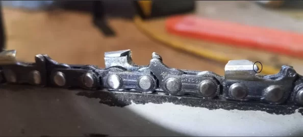

Hello,

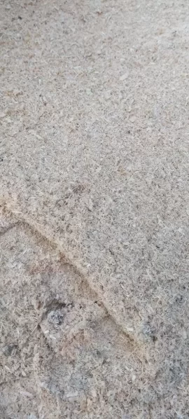

I have an Echo CS490 with the factory chain. I believe it's referred to as a safety or anti-kickback chain which has alternating cutters. I've used it between cutting up pallets (occasionally hit a nail), bucking, and felling small trees and limbs. I have a Harbor Freight electric chain sharpener which I use to touch up the chain. Lately I've noticed that I just can't get it to cut like it used to. It's gone between won't cut at all, with me applying pressure to the saw and the wood smoking, to cutting slowly with pressure applied and throwing sawdust instead of chips. I remember when the chain was new the saw would 'pull' itself into the wood. Now if I don't apply pressure to the saw it seems to just sit there and not cut.
There is plenty of material left on the cutters and they feel sharp to the touch. I have the grinder set for a 30 degree angle. The rakers are marked 0.025" and I even brought them down to 0.03" to see if that made a difference, but it didn't do much. Am I sharpening the chain wrong or is it just time for a new chain even though there seems to be material left on the cutters?
Pictures attached. Thanks.

That chain is nearly new. It's got plenty of life in it. But it is still dull. You can see that the hard chrome on the top of the teeth is worn away from the edge. The chrome needs to go all the way to the edge. It just needs to be sharpened more.
Either the angle of the grinder is wrong or the wheel needs to be reshaped. You're not getting into the gullet enough, it needs more curve to it. Compare the shape to a new chain and try to match that. There are specs for each chain for all three angles, you should double check the grinder is set to those. You also need to be using the correct width wheel. Usually that's 3/16 for a .325 chain. When using the grinder take small taps of the wheel on the tooth. If you let it sit there the tooth will overheat which will affect the metal. The teeth don't look blued so you're doing ok on this.
I'd suggest buying a few files of the correct size for this chain, and an Oregon sharpening guide, the flat plate kind. I think filing is a better way to go than a grinder especially a cheap one that's harder to use because it's got play in it. This is the right one if your saw has .325 chain: https://www.oregonproducts.com/en/o...r-sharpening-0-325-in-pitch-saw-chain/p/25896
Don't wait too long before sharpening. I go a max of two tanks of fuel, even if it's still cutting ok. If the chain's making dust I'll put another one on or finish with a second saw that's got a sharp chain. It's more pleasant to run a saw with a nice sharp chain, and easier on the saw and operator as well. It also makes sharpening less of a chore, just a few file strokes per tooth.

need to take the teeth back further . that point is still rounded in and i also see the top edge rounded. 3/16" wheel on a .325 chain ? I think 1/8" might be better.

Yep, pretty much what everyone else is saying. The cutting edges of your teeth are not even showing. Nothing wrong with a grinder but...learn how to hand sharpen first so you learn what to look for in a sharp tooth. It takes some time, but once you learn what to look for, you'll be very pleased with your results. Go on YouTube and check out "Buckin Billy Ray Smith." He's quite the character but knows what he's doing. Be kind! Mind the Gullet!

Thank you for all the replies. I do have a hand file similar to the ones shown but haven't tried it yet. I had been using the grinder to touch up the chain. I looked at some close ups of new chains and saw how the top edge of the cutters wasn't sharp on my chain. I think I was flexing the grinder (it is mostly plastic) and spending too much time making the area below the top cutting edge sharp. I carefully set up the grinder and made sure it would take off the edge of the cutters. Then I went through and re-did the entire chain, taking care to cut into the gullet area. The saw is back to pulling into the wood and throwing chips again! It was a day and night difference. I will work on touching up with the hand file and see how that goes.
