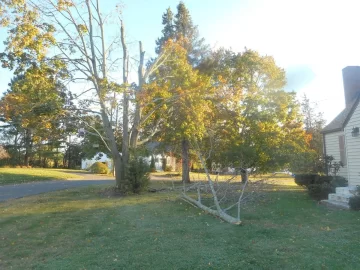

Unfortunately don't have a depth gauge. I do know the file shouldn't be in contact with the cutters on the return stroke. Yea, I'm thinking this time I better buy a new chain, but may invest in more than just a file for the future. Wish I bought the chain yesterday, lost part of a tree last night after a storm. No power for about 10 1/2 hours.
