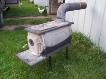

I'm pretty sure there is no clearance reduction allowed with this stove.
I don't think I would want this in my house
The good here....the bottom 15% of this boxwood hasn't glowed cherry red near meltdown point!
