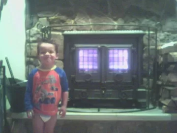

Well I got the Coalbrookdale installed and shes running great!
Been burning wood for about a week and coal for a few days. I can't believe it but coal is a little less of a mess then the wood and will burn all day and night. Only problem I see is the frequency of Ash dumps. I need to empty the ash pan every day. I experimented with stove coal after using Nut Coal and the nut just seems to be easier. This thing is keeping my 2800 SQ feet house nice and warm when temps get down to 30's at night.
I got to thank all of you for your advice.

That is a nice looking design. Good job. Looks like you have a good little helper there.
Great looking stove you have there. Looks like you'r helper likes it too.
My Helper? That's me....Just kidding
Thanks Guys, the town of Shropshire and Coalbrookdale seem like great places. I read allot about the history of the Coalbrookdale foundry and Abraham Darby.

My little buddy knows to stay clear of the stove, the screen cover works great to ensure no one touches "Hot Hot Daddy" he says. I also installed 4 CO detectors call me paranoid...

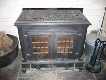

Great to see another Coalbrookdale! Here's a look at ours.
We moved into a house with one a couple years ago -- just burning wood in it (haven't tried coal yet). It's a great stove.
I confess we've toyed with the idea of replacing it with something like the Dutchwest non-cat. The clear glass and cleaner air are very tempting. But we're thinking long and hard about it. Instead of going that route, we're also thinking of replacing the glass/mesh combination on the doors with a dealer-suggested glass plate without the mesh, hoping we can see and enjoy the fire (though maybe it will get sooted up anyway).
