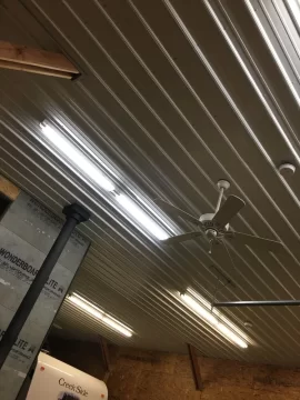

I know most of us on here tinker and as we all know good lighting in the shop is a huge help especially as we get older! I replaced my aging T8 bulbs with the led direct wire bulb. What a difference!! And my trailer I picked up this fall to haul stoves, pellets and my Grasshopper when needed. What do you all got? :)

I have a shop with the same white metal ceiling. Tons of t8 fixtures. 1000 watts when both switches are on.
So did you just bypass the ballasts, use the same tombstones, and pop in the led tubes?
If you are asking me, I did the ballast delete on the existing fixtures and used the tombstone ends., but I also have some dedicated LED fixtures as well. Like I said, the one downside is, when you loose an SMD, you loose the tube. The upside is the current draw. The entire shop on LED's draws maybe 1/4 of what it was on T8's. I can eat that up pretty quick when I fire up a big 3 phase motor or fire up the TIG welder.
Other plus is, LED's are basically unimpacted by colder temps. My shop is heated and air conditioned but I don't keep the ambient like in the house where the corn stove is always chugging. The shop has in floor PEX and I hold the slab at 60 in the winter.
Reactions: Highbeam
Exactly. Just wired 8 ends as neutral and 8 centers as line and marked it. Very easy, there is plenty of wire in there to do it. Led bulbs are polarity sensitive. bulbs are marked line and neutral. I checked amp draw before and after, it reduced by almost half

So, after reading this thread one of my ballasts failed in a t8 fixture. It’s actually cheaper to do this led conversion than to replace a ballast.
Turns out that these led t8 bulbs actually make much less light output at 1800 Lumens than the t8 at like 2800 but since they are directional, the output is equivalent if not slightly brighter. Half the wattage and instant full power.
I converted 20 bulbs so I save 360 watts anytime they’re on. [Hearth.com] Shop lighting, tool and ect.
