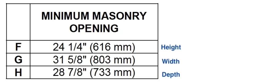

Depth seems to be the major one I need to check. The WinterWarm we have is wider than the minimum there and is just a half in shorter than the Osburn so I should be there. However, the WinterWarm seems to be about 10” shorter than the Osburn so I need to check the depth.

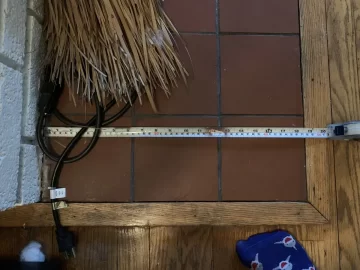

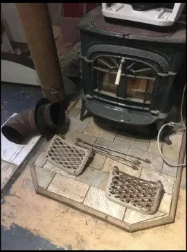

So, potential problem. The hearth extension from the fireplace is only 18” as seen here.
In fact, the current install isn’t up to code as the WinterWarm door is 14” not 16”.
Doesn’t the Osburn 2400 have a good amount of poke? See photo for reference but I think this means I can only have about 2-2.5” of poke for the front door if any insert or freestander.

Manual says R value of 1 or greater if hearth isn’t 4” higher than combustible floor. How can I determine if this tiled hearth has any R value?
Friend of a friend also has this Intrepid II for $100. Seems like it will fit but I’m not 100% sure on the overall condition.
Again the only measurement I need to confirm is depth of my fireplace. I believe my current insert and the Intrepid are similar though so I should be good, although it would be nice to pull it forward a bit, maybe 1/3 out of the fireplace?
Nice to have a couple options available…$100 is nice if this stove doesn’t need 5 parts replaced and countless enamel chips.

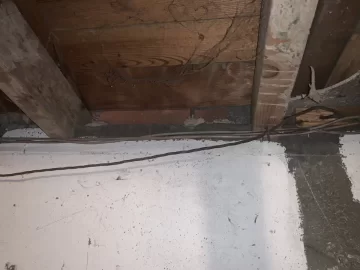

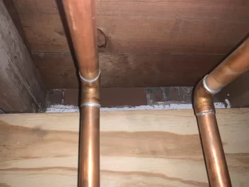

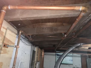

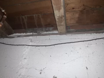

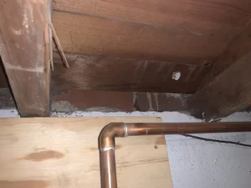

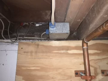

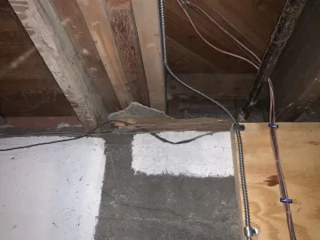

Just took a bunch of photos. I believe the fireplace and insert are just a bit to the right of where the boiler exhaust meets the foundation.

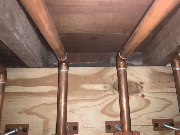

I tried to photograph the arched area below the fireplace/insert area. I’ve never seen anything like it, quite a marvel of engineering for the 1920s. Looks like there is broke and mortar back there but I’m hoping you can tell me more.
I will remove the surround tomorrow to measure depth and check the floor level of the fireplace.
Let me know if I should take more photos:
[Hearth.com] Shopping a used wood stove[Hearth.com] Shopping a used wood stove[Hearth.com] Shopping a used wood stove[Hearth.com] Shopping a used wood stove[Hearth.com] Shopping a used wood stove[Hearth.com] Shopping a used wood stove[Hearth.com] Shopping a used wood stove[Hearth.com] Shopping a used wood stove[Hearth.com] Shopping a used wood stove
I'm not certain why they did the arched form for the hearth extension support, but it looks like they never removed the form if there is cement above it.
So there is a suitable non combustible hearth extension here? Would the fireplace floor composition confirm this?
No that isn't a proper hearth extension. The forms and framing under it cannot be there. It is questionable if it would be able to support itself without that though.
Now you can check the hearth requirements for each stove in question. You may get lucky. But that certainly isn't safe for an open fireplace.

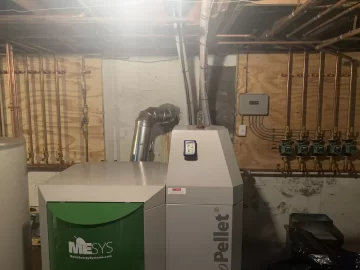

We have an awesome pellet boiler that does our heat and hot water. I want power failure security, ambiance and some extra heat on those super cold days.

Definitely doing an insulated liner(it’s a mostly exterior chimney). I’m hoping when I get my boiler liner swept I can get them to remove and take my old insert with them. That will make this process MUCH easier.
