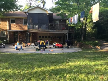

I’m considering adding a second wood burner as part of a walk-out basement remodel. I have a functioning fireplace downstairs right now that is has an 8” liner. The upstairs woodstove has a separate flue in the same chimney. Heating needs will need to be addressed as they tend be to inadequate now and we will be adding 400sf of space that will need to be heated.
The layout of the walkout basement as seen in the photo has one bedroom to the left, a playroom behind the fireplace, and a large two car garage behind the wall with the rainbow that is the full depth of the house. The stair way is open to the upstairs living room with the F400. The flue is 23’ from damper and has on offset bend but you can still see a bit of daylight.
The remodel plan is to add double doors to the garage or completely remove the rainbow wall and finish the garage as a multi use living space. The basement has always been colder than upstairs and was really cold this winter as we didn’t use the heat pump much at all. During the summer is always much cooler down there than upstairs.

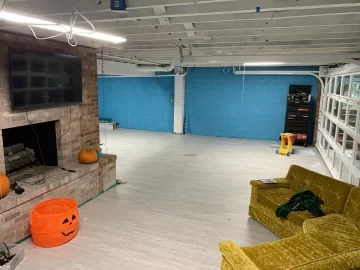

That space looks like it would be a bear to heat in anything but a mild climate.
I’m sure it would be. Our water meters are only 6” deep. We average 2400 heating degree days. We’re not done yet with the project. Been weighing the cost benefit of insulation and framing in block walls. Also been weighing heating versus cooling needs we run 2200 cooling degree days. And to be honest it just doesn’t stay cold here. Average December high is 56F. So I can probably get away with it . Kids thinks shoes are optional year round in the back yard.
Thanks had to pick a complementary wall color for it. Had bumper wheat crop in the early 70s and my grandmother had it recovered. Just can’t find gold crushed velvet furniture these days.
I love the sofa!
Reactions: SpaceBus
