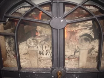

Should I be worried?? picture
ckarotka
Sep 21, 2009
641
Northwest PA on the lake
This is after about an hour into the burn. All controllable air has been shut off 100% The pipe thermo is at 350 and the stove top is at 550. I noticed since the outside temp dropped I have less control as expected but this is one piece of hard wood the rest is soft. Dried to 18-20% Do I have a leak or is this normal secondary burning??

How long has the air been shut off? My stove will do the same thing for about ten minutes if you shut the air off all of a sudden. You need to do it gradually. I do it on purpose somtimes cause it looks cool, but it's probably not the best way to burn.
Hard to see any secondaries, really...though if the wood is charred well, they always seem to diminish. Even harder to see evidence of a leak. 550/350 is nothing to worry about. ...Well, I might worry that it was burning a little cold and what's going to happen when the real chill sets in late Jan/ early Feb.
You can't completely shut the primary air down on a EPA stove. They are engineered to not let you smolder a fire so there are unregulated air intakes in all of'em.

I know there is still air coming in but I have closed all the air intakes that I can control.
I guess it was some premature posting because about ten min after it started to come down some
I am still not used these temps. The last three years I have run this stove wrong until I found this site.
Now I'm running correctly with good wood and monitoring temps. My main concern is when is 5f outside and I fill it full of good hardwood will it runaway on me even if I start turning in down in time. Here's my normal operation:

Sounds like you're getting the hang of it. I'm suspecting that when it's 5 °F outside, you will be happy with a stove top at 650. It's why the emphasis on installing the stove properly, according to or exceeding mfg clearances and with good pipe. That way you don't start sweating till it passes 800. :ahhh:
I think you're burning just fine, and I think you're smart to be asking these sorts of questions. The pic looks to me to be one of a very nicely burning split. No worries. Rick

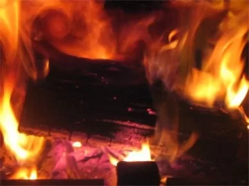

Here you go, then, good sir knight. Some of teh "evil pine" burning in the Endeavor: :lol:

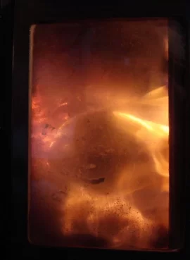

I wanna play too. The 30-NC first fire of the 07-08 season.

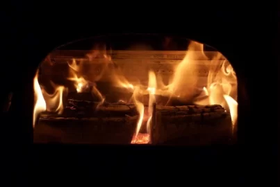

pre secondary burn tube machine needed a demon to rev it up

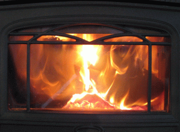

Settling in for the night at 650 stove-top cruise temp.
