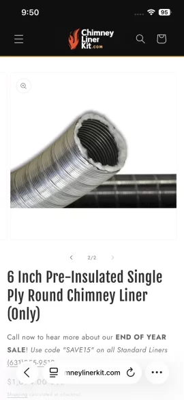

Lime this is what I’m talking about. 316 single wall with 1/2 insulation and the “casing” pipe or outside pipe is aluminum but I thought it was stainless per the salesperson I talked to and bought this from.

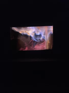

Wanted to report back. Chimney came back good, crown needs some work that I will address. I want to shout to begreen for his advice, but instead of limiting the primary airflow I put a magnet on the secondary intake which has been my problem. So far so good my flue temps is 455 and I am learning on when to shut the intake air completely down. I bought a damper but I misread what it said so it needs sent back. I truly do believe my problem is an overdraft and to much secondary air problem. Will update as I find things out. You all have been awesome and helpful

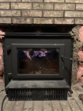

Wanted to send a quick update on how it looks. Flue temp got up to 496 had me a bit worried but it’s starting to settle out now.

Nice secondaries!

I’ve had those secondaries going non stop for awhile now and they’re not slowing down. Got the house up to 77 degrees and the wife is complaining on how hot it is lmao. I appreciate your advice but I went a different way and seems to be working at the moment.

Seeing those photos makes me miss my NC30 at the old house...
