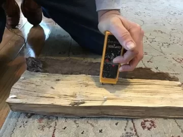

Can you describe your testing procedure?Yes there is a ceiling fan set to push air down. It's about as far away from the stove in the room as it can be though. Tested our wood yesterday, and most of it actually seems pretty good with a moisture level below 20. That fan pointed to the back of the fireplace is amazing , and I can really feel the difference using it.
This is my first time using a moisture meter. It is the 'general' brand and I was just sticking it into the cut side of the wood as far as it would go. Is that right? I don't think we have a flu problem. It's a 6" steel liner in an interior masonry chimney. Its about 20 feet. No issue with draft or smoke coming into the room. Maybe supplementing our wood (which is admittedly somewhat variable) with the compressed bricks would push the temp higher. Just took a look through the manual to see what temp the stove is supposed to run at but didn't see any guidance on that. I had assumed that 500 was great based on our stove top thermometer which actually shows 600 as an overfire.Can you describe your testing procedure?

Ok a few things there. The way to get an accurate moisture content measurement is by resplitting a room temperature piece of wood and testing on the fresh split face. Your wood is probably too wet.This is my first time using a moisture meter. It is the 'general' brand and I was just sticking it into the cut side of the wood as far as it would go. Is that right? I don't think we have a flu problem. It's a 6" steel liner in an interior masonry chimney. Its about 20 feet. No issue with draft or smoke coming into the room. Maybe supplementing our wood (which is admittedly somewhat variable) with the compressed bricks would push the temp higher. Just took a look through the manual to see what temp the stove is supposed to run at but didn't see any guidance on that. I had assumed that 500 was great based on our stove top thermometer which actually shows 600 as an overfire.
The temperature ranges on those magnetic pipe and stove top thermometers are a bit arbitrary. I don't measure my stove top anymore, just go by flue surface temp. If you have double connector pipe, you need to measure the inside of the flue with a probe thermometer. My stove is a similar shape and functions similar and I used to get temperatures of 800df or higher at the peak of the burn. During our first winter we had to supplement our wood with the compressed sawdust bricks. They did the trick and were definitely worth the money. Our wood was mostly dead standing spruce and fir, the moisture content was probably around 25%, a bit too much water for a modern stove. Loading up the stove with half bricks and half cordwood was optimal for burn times and stove temperature.This is my first time using a moisture meter. It is the 'general' brand and I was just sticking it into the cut side of the wood as far as it would go. Is that right? I don't think we have a flu problem. It's a 6" steel liner in an interior masonry chimney. Its about 20 feet. No issue with draft or smoke coming into the room. Maybe supplementing our wood (which is admittedly somewhat variable) with the compressed bricks would push the temp higher. Just took a look through the manual to see what temp the stove is supposed to run at but didn't see any guidance on that. I had assumed that 500 was great based on our stove top thermometer which actually shows 600 as an overfire.

Wow, great detective work. You guys really are amazing. Yes, just looked up my thermometer and it's intended to go on the stove pipe.Ok a few things there. The way to get an accurate moisture content measurement is by resplitting a room temperature piece of wood and testing on the fresh split face. Your wood is probably too wet.

Yeah I think you must be spot on and our wood is too wet. I'll have to wait for our meter to arrive and test it right.The temperature ranges on those magnetic pipe and stove top thermometers are a bit arbitrary. I don't measure my stove top anymore, just go by flue surface temp. If you have double connector pipe, you need to measure the inside of the flue with a probe thermometer. My stove is a similar shape and functions similar and I used to get temperatures of 800df or higher at the peak of the burn. During our first winter we had to supplement our wood with the compressed sawdust bricks. They did the trick and were definitely worth the money. Our wood was mostly dead standing spruce and fir, the moisture content was probably around 25%, a bit too much water for a modern stove. Loading up the stove with half bricks and half cordwood was optimal for burn times and stove temperature.
You should easily be seeing 700 in the middle of the cooktop. I've seen over 900 on mine and I have a very short chimney - but I have very nice dry mulberry firewood and I pack the stove full. Let us know what you find when you get your meter and follow the testing procedure mentioned by other posters above.I'm having trouble getting the stove top hotter than 500. I'm not sure if this is because of the self regulating function of the stove or because our wood is not dry enough. I ordered a moisture metre and have a friend bringing one over today so I'll be able to check the wood later. The fan blowing to the back of the fireplace has helped though!
