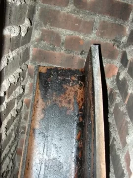

I took some pics this afternoon.
First one is one I posted here last Nov. 3 showing a clean flue.

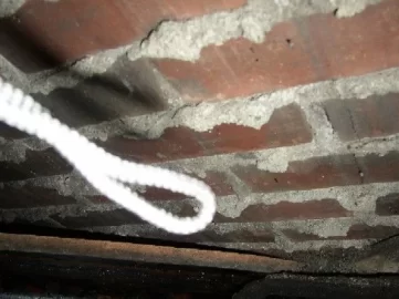

Second is showing the big chunk broken back into the brick chimney hollow. You can see there is no soot anywhere except on the tile inside.

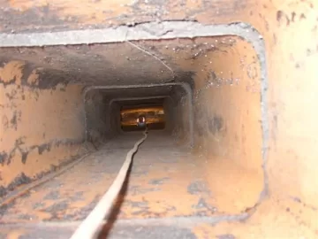

Third is the breakout against the outside brick. You can see the mortar is clean, so that proves the flue was broken after the heating season.

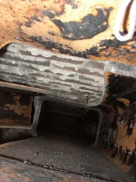

Fourth is a shot of the flue wall towards the house with the breakout on the right.

Strange, maybe he broke it while cleaning and didn't say anything.
Might be the pic, but #4 looks like that creosote is cooked, as in a chimney fire. I certainly may be wrong though.
Possibly it had a fire, and cracked, and when sweep cleaned it, it fell in?
Looking at pics 2 & 3, looks like the broken endges in both photos show creosote on the edge? So maybe it was already cracked? Therefore the buildup?
