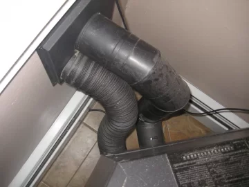

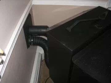

As u can see in the pictures, looks like a real hassle to open up anything behind the stove.
[lot less room than it looks to access clamps at bottom connections without pulling stove out some..
.. would sucking it all out from outside be just as good?
I have pulled the bottom cap to my short stack outside, looked up with a flashlight and see only Light colored gray ash so far,... 20 bags shy of 3 tons burned since November..
nothing black...

You should be able to get to everything through the stove past the fan. Just be very careful or remove the ESP. Then attack the rest from outside. May not even need a blower with the simple exchanger of the Harman system.

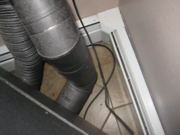

In that tunnel where the ESP is, I have been using a thin bristle brush and instead of pushing the ash, I pull it back towards the inside and then vacuum it there since
my attatchment is to big..afraid if I just push it forward, it will all lay in the bottom of the inside 90 pipe which goes up..[pix attached]..... or am I wrong in the logic?

Remove the ESP probe and also the cover plate over the exhaust blower....it sits behind the ash pan. Keep the ash pan and front doors open. If you don't, a leaf blower will spin the exhaust fan at frightening speed. I found that out the hard way. The good thing about the leaf lower trick was that after getting the stove properly deconstructed to handle it, I was able to use compressed air to clean out every nook and cranny in the thing and the leaf blower sucked it outside without a spec of dust getting inside the house.

my pipe[from the back of the stove] comes out horizontal for 6 inches, then up for 12", then horizontal for 6" again before going out the wall..[you can see the config in pix I posted top of page.]
your saying the flex brush like the above poster showed will go that route to outside? because I have 1 from HD that has 4 ft exstentions.. total of 8 foot long.. soft bristles.
