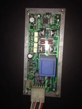

What information about the board would be relevant? I can provide that.

Also, can you take a pic of your control board? It may be the older version. I have an upgraded board, I got it free from Hudson River because the original did not have the on/off function, which it advertised at the time. So they sent me the newer version .

The control board is T200808 ver 1.1
[Hearth.com] Should I get a better stove?
The ash build up in the pot should not be happening that fast at that firing rate, likely you have a combustion air bypass. Is there a rim around your burn pot that has a space under it, a dense gasket under that rim that is is high enough to fill the height of the rim plus just a little bit more and the width of the area under the rim. Will seal any bypasses at the burn pot. Then as the pellet level goes down in the hopper is there a gap between the auger flight cover and the end cap so you can see the end of the auger turn? If so this should be closed with a bit of flat self sticking window gasket. The ash is going to land where the combustion air sends it and it is not likely we can do much for that.
I don't recognize that control board will need to do some searching. Tomorrow sometime.
